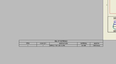

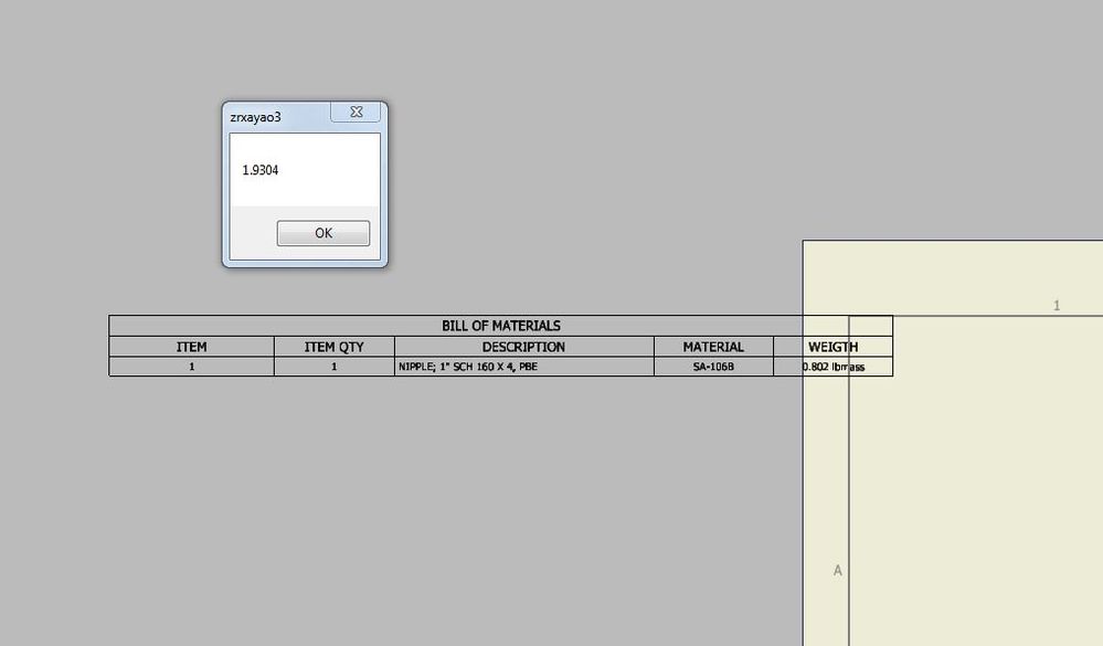

Brandon, no the reference point for the parts list table is to the top right. In other words, if you position the table at (0,0), the top right of the table will be coincident with the bottom left of the sheet (see picture below). So positioning the Y value at oBorder.RangeBox.MaxPoint.Y (top of the border), correctly positions the top of the table to the top of border.
As I said, it is the X offset that isnt working correctly. When I try to use +oPartsList.RangeBox.MaxPoint.X, it only moves to the right by like an inch or so, rather than all the way over to where the left side of the table is coincident with the left side of the border (see other picture below). And in fact as you can see in that picture, when I ouput oPartsList.RangeBox.MaxPoint.X to a message box, I get a goofy result (1.9304). So I think the issue is with the method I'm trying to retrieve the overall width of the table(?)
Located at (0,0)
Located at:
oPlaceX = oBorder.RangeBox.MinPoint.X + oPartsList.RangeBox.MaxPoint.X
oPlaceY = oBorder.RangeBox.MaxPoint.Y
MechMachineMan
Yes, it is your method.
RangeBox uses the box WITH RESPECT to the SHEET ORIGIN. Thus, as your PartsList moves, so will the location it puts it in.

You're correct about the position of the Parts List.
I think you need to calculate the size of the Parts List, then move it.
oPlaceX = oBorder.RangeBox.MinPoint.X + [width of parts list]
Giving you:
oPlaceX = oBorder.RangeBox.MinPoint.X + (oPartsList.RangeBox.MaxPoint.X - oPartsList.RangeBox.MinPoint.X)
BrandonBG
Thanks Brandon, that was the kick to the tire that got the engine started!
Mech, thank you for the explanation! That makes total sense now.
