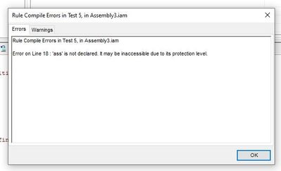

Message 2 of 14
bradeneuropeArthur
This is not needed.
Take a look at this sample piece of code!
Public Sub aaa()
Dim a As Application
Set a = ThisApplication
Dim b As AssemblyDocument
Set b = a.ActiveDocument
Dim c As ComponentOccurrence
For Each c In b.ComponentDefinition.Occurrences
Dim ass As AssemblyDocument
Set ass = c.Definition.Document
Next
Dim c1 As ComponentOccurrence
For Each c1 In ass.ComponentDefinition.Occurrences
Dim prt As PartDocument
Set prt = c1.Definition.Document
prt.PropertySets.Item(4).######
Next
End Sub
Regards,
Arthur Knoors

 Some problem is also with ass because is not declared correctly.

I still have this error:

You are really new to programming, but does not matter. I will prepare the complete code ASAP for you.
You need to provide me the steps you need with a complete setup of what you need in detail!
