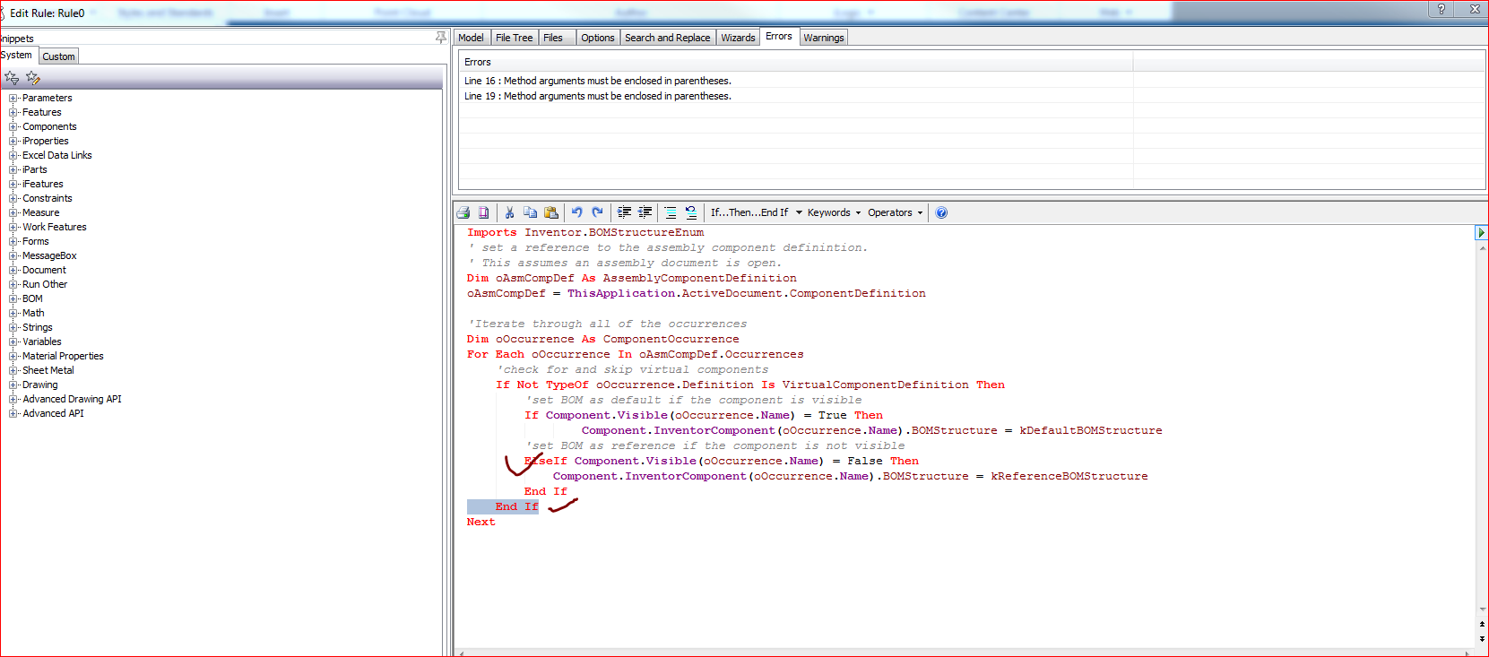

Curtis_Waguespack
Hi mohan.nakka,
There seems to be some mystery characters as shown.
If you retype the word BOMStructure in both places shown it should take care of it.
I hope this helps.
Curtis
Message 27 of 42
Thanks Curtis,
      That cleares the error message.I added this rule to an assembly file which has a view rep i created.i added this rule to fire with an event trigger "after save document".but none of the invisible components BOM structure is change to reference.Am i doing it right?Please help.
Thanks a lot
