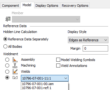

I'm trying to get the part document of a "Preparation" placed drawing view. On the image below, 10796-07-001-00.iam is the main weldment document. VIEW719 is pos.8 and VIEW720 is pos.11 (10796-06-001-11.ipt). These two are placed on the drawing via Place Views - Base - Model - Preparation(select part), see second image below. What I'm trying to get with iLogic is the part document of each placed view.

Hi @Nejc.Leban .
In this case, you can get an object of type ComponentOccurrence using the DrawingView.GetWeldmentState method. Example iLogic code:
Dim oInvApp As Inventor.Application = ThisApplication
Dim oView As DrawingView
oView = oInvApp.CommandManager.Pick(SelectionFilterEnum.kDrawingViewFilter, "Select View...")
If oView Is Nothing Then Exit Sub
Dim eWeld As WeldmentStateEnum
Dim oObj As Object
Call oView.GetWeldmentState(eWeld, oObj)
If Not eWeld = WeldmentStateEnum.kPreparationsWeldmentState Then Exit Sub
Dim oOcc As ComponentOccurrence = oObj
MessageBox.Show(oOcc.Name, eWeld.ToString())

Nejc.Leban
That works great, thank you!
