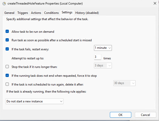

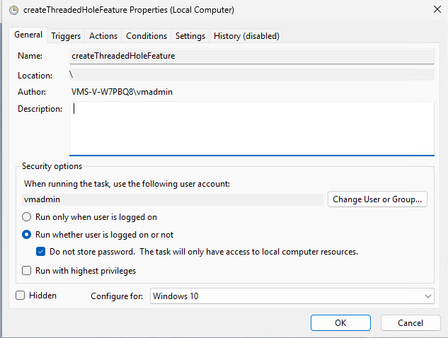

Here is some of the settings on our task that we use to start the program.  If we use the top setting, everything works.  If we use the bottom setting, we get the error.  I believe it says: "Unable to invoke object".

I asked my developer to create a small sample program that will do only this one thing so we can have something to share.  In the meantime, I thought it might be good to make clearer an observation about these settings.  This issue happens if you are logged in or not.  We can start this task ask the second option, leave the computer logged in, run the CAD request and it will fail.  Turn this setting the other way as shown below, and you it works every time.
Here are the other settings of the task that starts our console application.

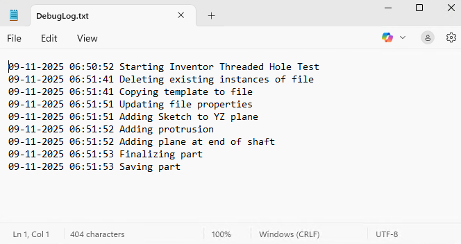

I got your project and tested here, I created a task in Task Scheduler as below and it works well:
Here is the log result:
Can you double check it there?
If this solves the problem please click ACCEPT SOLUTION so other people can find it easily.

Hi Rocky,
Did you run it while signed out?  I created the sample project and tested it the day I sent it in.  The error only happens when the user is not currently logged in, so the best way to do that is restart the computer and let the task start on its own when the computer turns back on.
