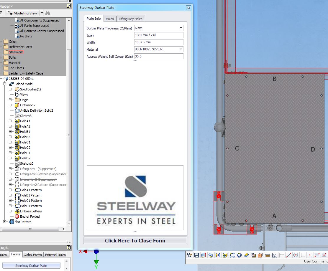

I'm trying to suppress and un-suppress a feature when clicking on iLogic tab.
Basically when i click on the tab for my iLogic form i want the emboss feature to become un-suppressed but when i close my iLogic from i want the emboss feature to suppress.
Is this achievable.
Any help would be great.
Dan

I want to suppress a feature in a part when clicking on button to close iLogic form
and for the feature to unsuppress when opening the ilogic form back up in the part.

In addition to last reply please see attached screenshots hopefully clarifying reply and question.
