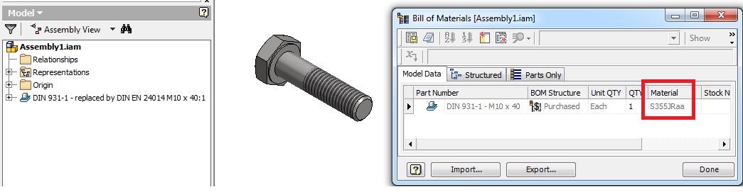

I wrote (by accident Smiley Very Happy ) a little piece of code that allows me to change the material of default content center parts (out of the box)
Strange, because i cannot change the material throught the interface of a standard cc part (default behaviour)
Even stranger is that i can add unknown materials, but through the iproperties the part shows allways the default (steel, mild ) material,
except in de BOM.
This is a very strange behaviour or even a bug/leak or is there another explanation for it? someone ever came across this?

frederic.vandenplas
Public Sub ChangeMaterialAssembly()
' Get the active assembly.
Dim oAsmDoc As AssemblyDocument
Set oAsmDoc = ThisApplication.ActiveDocument
' Get all of the referenced documents.
Dim oRefDocs As DocumentsEnumerator
Set oRefDocs = oAsmDoc.AllReferencedDocuments
' Iterate through the list of documents.
Dim oRefDoc As Document
For Each oRefDoc In oRefDocs
    oRefDoc.PropertySets(3).Item("Material").Value = "S235JR" '
Next
End Sub
Sub ChangeMaterialPart()
Dim oPartDoc As PartDocument
Set oPartDoc = ThisApplication.ActiveDocument
oPartDoc.PropertySets(3).Item("Material").Value = "S235JR"
End Sub
This code is quite simple but does the "trick"
