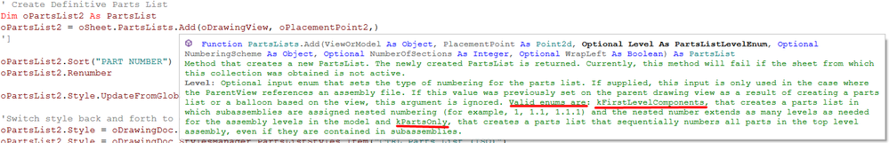

JoãoASilva
@dutt.thakar
If I change that it gives an error.
Expected, since it only accepts kFirstLevelComponents and kPartsOnly.
