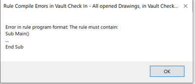

Does not work for me, I am getting this error....
Probably something simple
Message 5 of 10
JhoelForshav
@Anonymous
This is VBA not iLogic... If you want to run it as an iLogic rule you could use something like this 🙂
