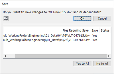

I came across a problem (bug?), if I use "Save()" command in iLogic, Event Triggers do not work properly (are not executed fully - exited?).
We are using Inventor 2020.3.4.
How to simulate this problem:
  1. Create IPT and its IDW.
  2. Create an iRule:
    If ThisDoc.Document.DocumentType = DocumentTypeEnum.kDrawingDocumentObject
    	ThisDoc.ModelDocument.Save()
    End If
    MsgBox(ThisDoc.FileName(True)
  3. Put this iRule inside "Before Save" Event Trigger (All Documents).
  4. Dirty both of the files (for example change dimension on IPT and go to IDW).
  5. Save from IDW.
Outcome:
It will only show IDW messagebox.
Other try:
  1. Do the same as above, but comment the save command:
    	'ThisDoc.ModelDocument.Save()
    End If
    MsgBox(ThisDoc.FileName(True))
Outcome:
It will show IDW messagebox first, then Save dialog (both yes and click OK) and it will also show IPT messagebox.
Why does Save() command skip execution of further code? Error or exited or as designed?

ReneRepina
@bradeneuropeArthur
I do not understand what you mean by "TRUE value".
It is strange that if you use Save() command, further code is not executed. Or is it the logic like, that it executes "Before Save", but if file is saved in between the code, it exits it?
I know msgbox is outside, it is on purpose, to see the outcomes. As you can see when model is saved, it does not executes to msgbox, because it exits it before.

ReneRepina
@bradeneuropeArthur
I also tried Save2(True), but it also does not work. Event Trigger on IPT is not executed in this case. If you comment it, it executes it.

ReneRepina
Greetings everybody.
Just to fill everybody with updated informations about this case.
@Olena.Rubin from Autodesk support and her team found out that above case is a defect. It is probably not iLogic related, but a general Inventor issue when saving model and its drawing from the drawing directly.
Tracking ID is INVGEN-66198 (see below link) and escalation ID is INVGEN-66301.
