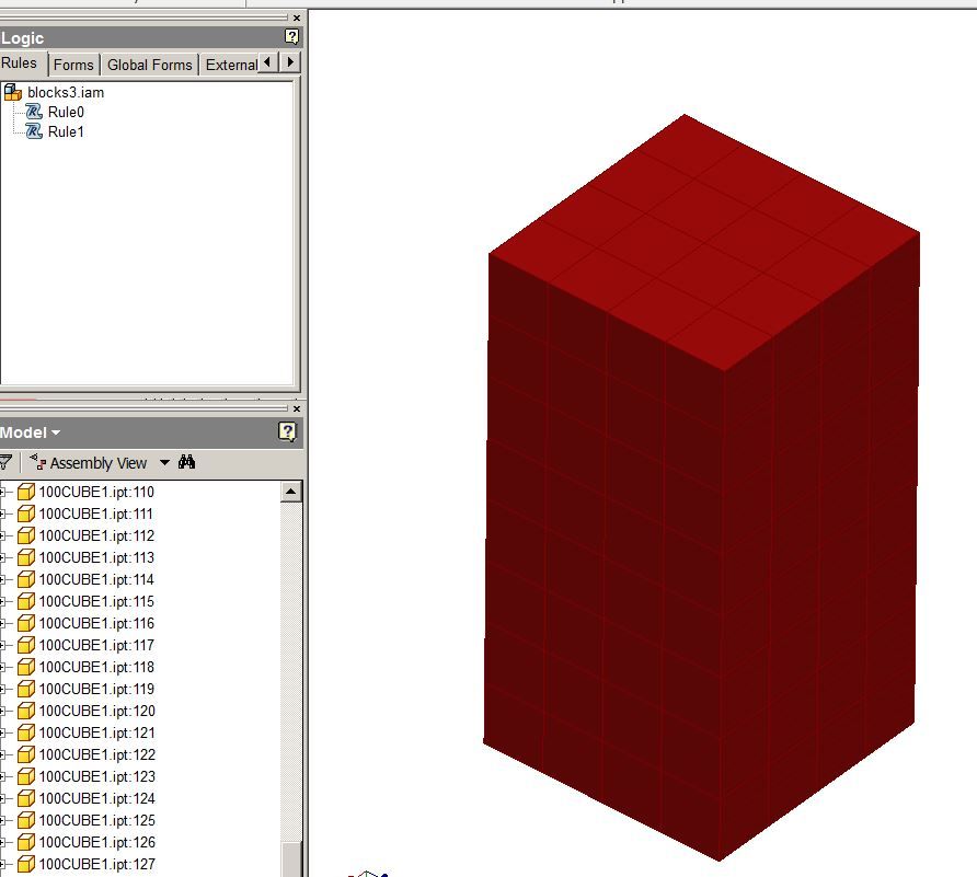

andrew_canfield
Thankyou.
Part inserted in red blocksPart inserted in red blocksPart inserted in red blocksPart inserted in red blocksanything with interference turned yellowanything with interference turned yellowRed blocks deleted - simple substitute next :)Red blocks deleted - simple substitute next 🙂

A slightly more rigorous test 1000 part assembly - took a while to process but the concept works.
Below the derived part is 26MB (LHS) & simplified blocked version 1MB (RHS)
Smaller cubes would improve the resolution.
Could someone take it further, make it faster?
