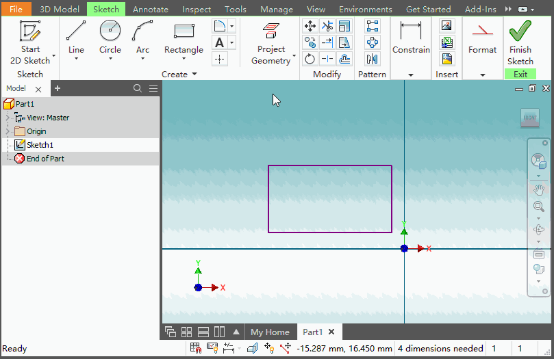

My macro code is as follows:
Public Sub selectset()
MsgBox "The cout of selectset is: " & ThisApplication.ActiveDocument.selectset.Count
End Sub
First, I draw a rectangle in the sketch, then I execute the offset command, then I select 2 edges of the rectangle, and finally I run the macro mentioned above, the result is 0.
How to get the selectset property in the command execution process ? For example, get the selectset count during the execution of the offset command.

lzs013

BrianEkins
Ok, I understand now.  Your original description was correct but I was misled by there only being two lines selected.  The default with the offset command is for it to automatically select a loop.
Anyway, the reason that you're not seeing anything in the select set is that when a command is running it has its own private selection and you don't have access to it.  The public select set is the set of entities that have been selected using the default Select command.  The Select command is the command that's active when no other command is running.  Pressing the Escape key causes the Select command to start and forces the currently running command to abort.
I'm not sure what you're trying to accomplish but in general, it's not possible to interact with other commands while they're running.
