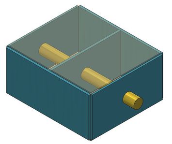

I can't do this control.
Could someone help me?
Only lack of control the dimension of derived.
Control the dimensions in the iam.

I want to control the dimensions by the form.

When they open the IAM will realize that the box of the form did not allow the dimensions to be edited.
All the dimensions are in the form's box.
Open the dialog box in the form and try to change.
The dimensions doesn't reflect on the models.
Thank you.

I'm sending the video to better understand the doubt.
Can you download the files I sent?
I found your video on YouTube.
and almost that.
Thank you.
Message 11 of 13
dgreatice
You wrong call that parameter in 03.05.0005.02:1, it must be call to 03.05.0005.02:1
try this,
1. Place Component 03.05.0005.01 to main assembly, place grounded, then make BOM > reference.
2. Check you rule in Rule0, you call that parameter in 03.05.0005.02:1?
3. change all become, example in first line: (Parameter"03.05.0005.01:1", "Comprimento") = Comprimento
Please use the ACCEPT AS SOLUTION or KUDOS button if my Idea helped you to solve the problem.
Autodesk Inventor Professional Certified 2014
Message 12 of 13
iva.btblan
Thank you for your help. Subject solved.
