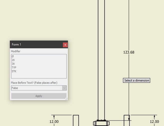

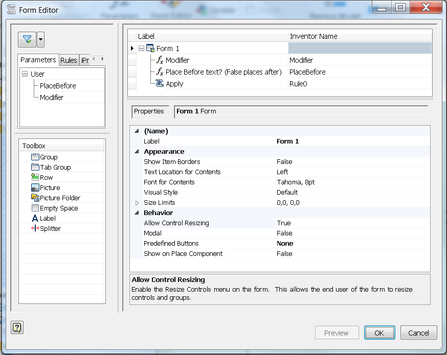

Here's what I've done:
  • Added "Ø" to the list (that and "2X" will probably get used 90% of the time)
  • Ran the rule once
  • Created the form, added the 2 parameters
  • Set the rule to the "Apply" button.
When I click "Apply", I get "select a dimension" besides the cursor (the cursor doesn't appear in my screenshot).
When I click on a dimension, I hear the "beep", but no text is changed. And no other "beep" if I click on subsequent dimensions. I feel like I'm so close! Did I do something wrong?
