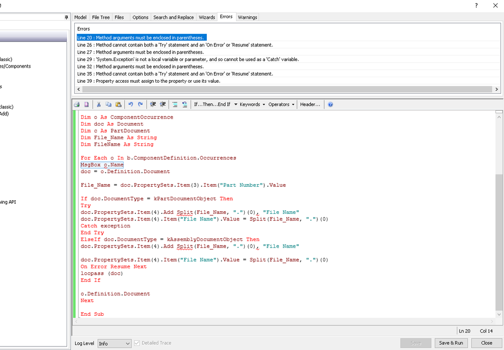

Hi , sorry  ,I-logic not working

Public Sub Main()
Dim a As Application
 a = ThisApplication
Dim b As AssemblyDocument
 b = a.ActiveDocument
loopass (b)
End Sub
Public Sub loopass(b As AssemblyDocument)
Dim o As ComponentOccurrence
Dim doc As Document
Dim c As PartDocument
Dim File_Name As String
Dim FileName As String
For Each o In b.ComponentDefinition.Occurrences
doc = o.Definition.Document
File_Name = doc.PropertySets.Item(3).Item("Part Number").Value
If doc.DocumentType = kPartDocumentObject Then
'MsgBox(doc.PropertySets.Item(4).Item("File Name").Value)
doc.PropertySets.Item(4).Add (Split(File_Name, ".")(0), "File Name")
On Error Resume Next
doc.PropertySets.Item(4).Item("File Name").Value = Split(File_Name, ".")(0)
ElseIf doc.DocumentType = kAssemblyDocumentObject Then
loopass (doc)
End If
Next
End Sub

Message 9 of 18
eladm
Hi
The result is part number , I need the file name
the file ilogic_test.ipt have part number eeee , the result of the rule is part number
if part added to the assembly or the part number changed , run rule failed
Error in rule: Rule0, in document: Assembly1
The parameter is incorrect. (Exception from HRESULT: 0x80070057 (E_INVALIDARG))
