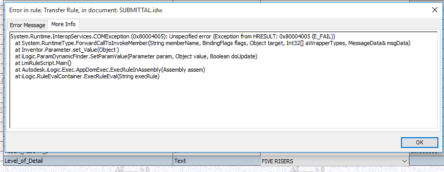

does anyone know why this error message pops up when I am changing LOD from idw file? (the LOD is in one of the assembly files)
411 Views
PS: I am trying to use ilogic to change the LOD, so I dont have to go into view properties to change it.
MechMachineMan
You read the error stack from the bottom up.
It's saying that when you try to change one of the dynamic parameters there is an error.
Without your code, we cannot tell you much more.

Justin,
here is the one line of code in the idw, to transfer the idw parameter to the assembly:
SyntaxEditor Code Snippet
Parameter("SUBMITTAL EXPLODED VIEW.iam.Level_of_Detail") = Level_of_Detail
 here is the parameter in the idw, it is multi-valued text, the parameter in the assembly file looks identical to this:
here is the code in the assembly file, so when I change the parameter, LOD changes.
iLogicVb.UpdateWhenDone = True
If Level_of_Detail="FIVE RISERS"Then
ThisApplication.ActiveDocument.ComponentDefinition.RepresentationsManager.LevelofDetailRepresentations("FIVE RISERS").Activate
iLogicVb.UpdateWhenDone=True
ThisApplication.ActiveView.Fit
ElseIf Level_of_Detail="FOUR RISERS"Then
ThisApplication.ActiveDocument.ComponentDefinition.RepresentationsManager.LevelofDetailRepresentations("FOUR RISERS").Activate
End If
any hint on how to resolve this problem would be appreciated!
