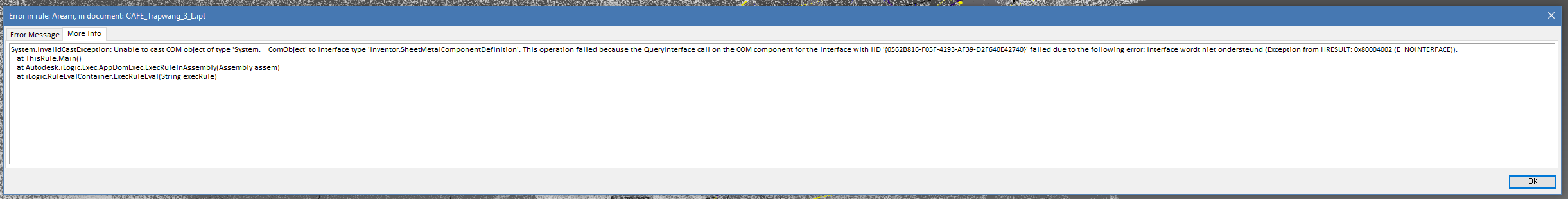

I have the following problem. See screenshot for the error message.
If i save the parts in part then i don't have an error. When i update an ass and i save it i get an error on each sheetmetal part. Below is my ilogic.
Hope someon knows the problem.

One of the things you have to think about when writing rules is if it should run on the document the rule stored in, or on the currently-active document. In general, most rules are intended to run on the document the rule is stored in. To make that happen, change this line:
oDoc = ThisApplication.ActiveDocument
to this:
oDoc = ThisDoc.Document

Stupid mistake! I had other rules with the same problem!
Thank you for the solution!
