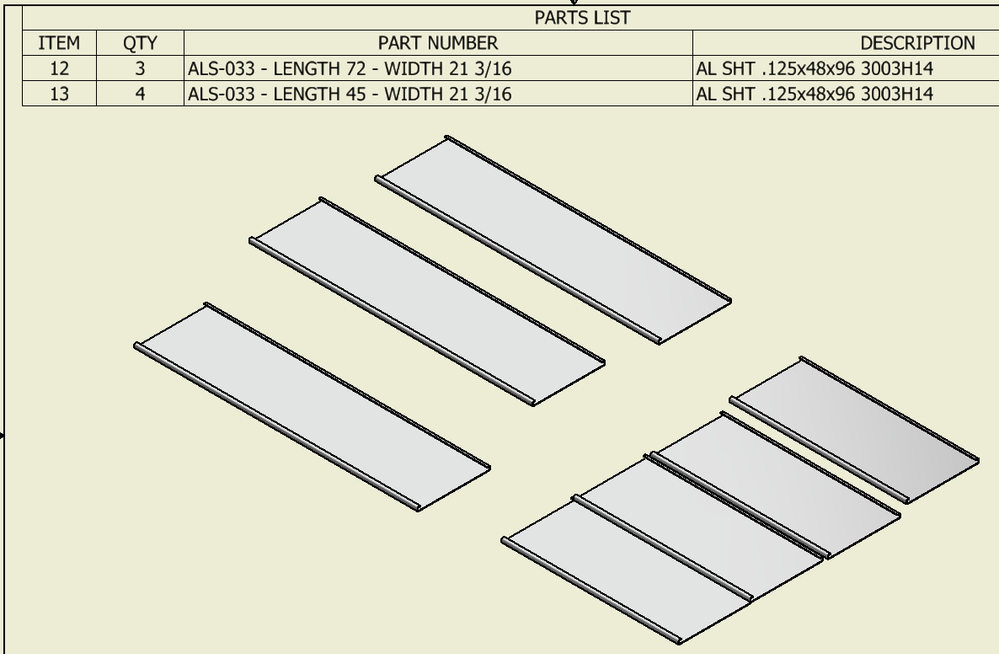

The only issue is the rule is overriding the parameter precision settings. It is displaying full value, see image:
The rule even updates the extents values if I do have to make a change in the assembly. My vba is quite weak. Can someone help me, if it is possible to convert the extents values to fractions to a precision of 1/16", if not then how to round down to the nearest .001.

A previous post here help me figure out how to convert to fraction and round up. Thanks! @Anonymous
Got what I am looking for, unless there is something that may be troublesome down the road. I can Merge my parts by Product Identifier and sizes.
The rules can be found in the attached part file.
