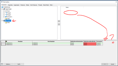

Hi all,
I want to create a metal sheet iPart where I would have 2 configurations:
1. Folded
2. Unfolded
Where is the property that I have to grab on the iPart author?
Thanks!

Hi Theo,
thanks for your reply.
My metal sheet part is created in two steps (manufactured):
1. Bending process: modeled as 2 flanges
2. 45degress cutout: modeled as Cutout extrusion
I need to have 2 configurations:
1. the flat pattern without the cutout for the laser cutting. (DXF)
2. bent pattern with the cutout for the sawing.
For that, I need to create iPart where
1. Flat Pattern property is active and the cutout is suppressed.
2. Folded Model property is active and the cutout is active.
