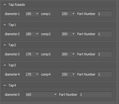

How is take the part number the side forms how the consequence the dimensions I chose in form?
Message 10 of 11
martinhoos
Hello Aron,
sorry, but i didnt understand your question.
Regards from Germany
Martin
Message 11 of 11
aronmatheus
Hi, Martin! I would like to change a dimension in the form there the consequence change a part number to the same form, to show when I change the dimensions see what part I'm chosen.
