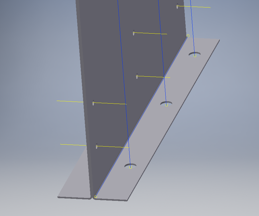

Hello together,
is there a way to calculate the axial alignment of holes to see if they fit?
Thank you very much
Georg

To compare the axis and the holes one after the other is the best way. I do not like to modify the parts.

GeorgK
Hi @chandra.shekar.g,
your code for checking all holes is really a time saver. The axis are very good to see the alignment. If the holes are in red or green and with a number with the clientgraphis this would improve the process to find it.

To check all the hole variations is very complex. How could I check if there is any srew or pin etc. in the hole and get the name? Do I need to use the AnalyzeInterference or is there any other possibility?
https://forums.autodesk.com/t5/inventor-customization/collision-tapped-holes-and-srews/m-p/6493440#M...
Georg

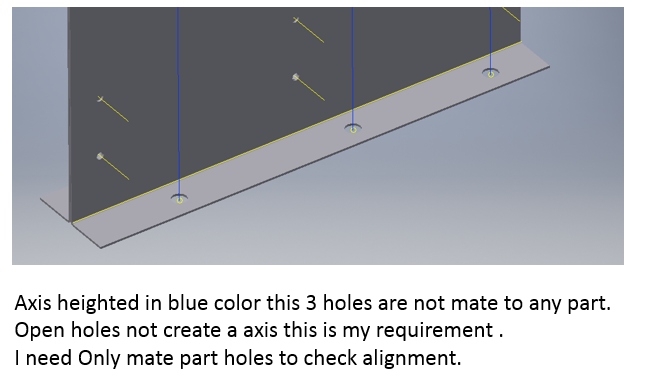

Hi @GeorgK,
Try the following VB.net code which lists all aligned and misaligned hole. It also writes to text file.
Sir
your all codes for (hole alignment) is very useful for our ongoing project thank you so much.
its working fine but my requirement explained below.
hole alignment code it will check in only axial direction,i need all directions.
Please find the attached image.
Thank you
Regards
Naveen

Message 31 of 43
Hello Sir
My requirement
After  run the macro it will create axis for all holes and cylindrical surface (like bend radius also it will create axis).
I need fix for this only it will check for hole feature.
In attached image heightened in blue clour axis ,after the macro axis will not create for this area and it will not check for hole alignment for
open holes (not mate any part).
Thank you
Reagrds
Naveen

Sir
i am trying to explain my requirement in attached image.
Marked in red co lour holes surface not mate to any surface.
After run the macro this holes are going to generate the axis .
how to skip this kind of holes to create axis nad if part having bend radius for that also it will create axis.
Please support on this its very argent in my ongoing project.
My project contains very big assembly and most of the parts are curved surface.
Thank you
Reagrds
Naveen
