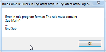

The reality is that unless you tick the "Straight VB Code" button here:
iLogic complains that:
2017-03-31 13_17_08-Rule Compile Errors in TryCatchCatch, in TryCatchCatch.iLogicVb.png
Which doesn't help much.
I assume this is because iLogic only accepts the one Try Catch End Try...?
