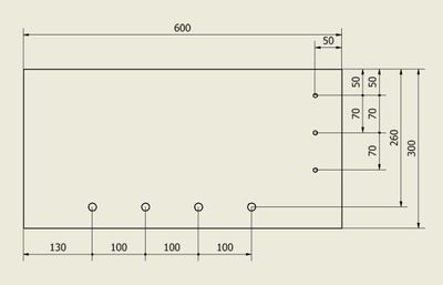

When changing the parameters of a part, the dimensions in the drawing fly off.
But I want to get the correct position.
Method ChainDimensionSet.Arrange( BaseDimension As LinearGeneralDimension )
It does not work for me or I do not know how to use it correctly, it centers the text but the size itself does not move to the right place. If you run a rule to count the number of linear dimensions, it turns out that the ChainDimensionSet is counted as separate dimensions. Maybe they can be collected in separate collections and then properly sorted by type. If you can't sort by designation here
and position them by specifying the coordinates?
Does anyone solve this?

But here is not to arrange dimension lines in a parametric distance depending on each other using standard methodsю if CainDimensionSet gets into the collection. He doesn't move and stays in the wrong position.
I need to get this result

it does not place the CainDimensionSet i at the correct distance from the drawing. It matches all other dimensions but not CainDimensionSet. I need to solve the problem if the set of dimensions also includes these dimensions so that they are all aligned equally.
Message 14 of 17
vvvxxvvv333
I have this initial posture
 using any handling rules I can find I get this
 But I had to get it this way
