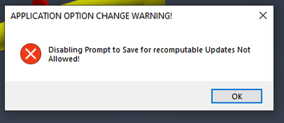

bradeneuropeArthur
Why are the Application Options Changed when Using the..
dim a as Object = (thisapplication.CommandManager.Pick(selectionfilterenum.###,""))
If you have enabled the ApplicationEvent.OnApplicationOptionChange
Private Sub m_inventorApplicationEvents_OnApplicationOptionChange(BeforeOrAfter As EventTimingEnum, Context As NameValueMap, ByRef HandlingCode As HandlingCodeEnum) Handles m_inventorApplicationEvents.OnApplicationOptionChange
This is always fired then.
The message is from my add in but shows that this option is changed.
An unwanted situation.
Question is why and for what reason.
@johnsonshiue Do you have any idea about it?
