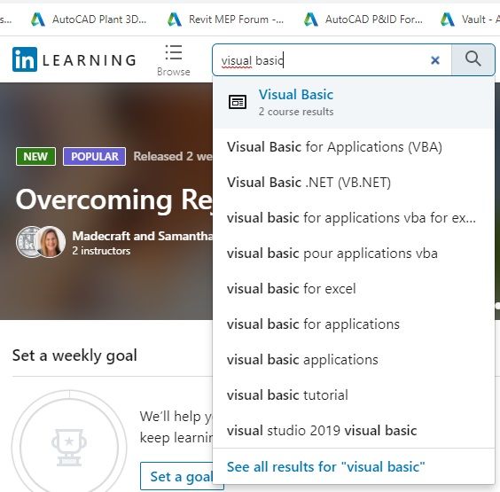

All I have code-wise are snippets that I found or from other people, so no programmer in me (yet)

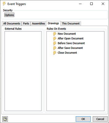

I can do this with an external rule, but still need to add the event trigger to all existing drawings.
Maybe it is time to start learning code 🙂 Any good starting pointers?
Where should I begin with creating those add ins.

Inventor 2025, Vault Professional 2025, Autocad Plant 3D 2025
bradeneuropeArthur
You can do that in the application.
No need to do that per drawing.
See my screenshot.
