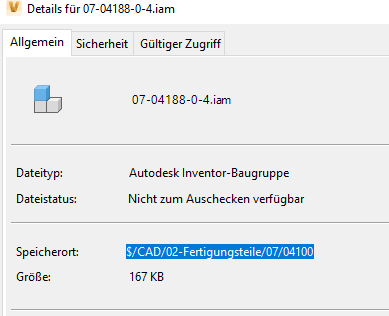

find the part in vault. right-click -> Details
what does it say for the location?
Message 12 of 26
Darrell.johnson
Message 13 of 26

you need to replace this:
VaultPath = oFilePath.Replace("D:\Working Folder\", "$/")
 with this:
VaultPath = oFilePath.Replace("C:\VaultWorkSpace\", "$/")
Message 15 of 26
Darrell.johnson
Now it works perfectly! Thank you very much!
