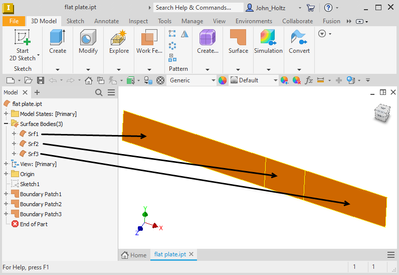

First, a question for the Inventor modeling experts. Is there a way to create a surface model that has N faces but one surface body, instead of N surface bodies with 1 face in each body? For modeling shells in Nastran, it would be better to have 1 surface body with 3 faces instead of 3 bodies. For a flat plate like this example, it is easy to split faces. For 3D structures, I do not know how to put all the surfaces into one surface body.
Figure 1: Three surface bodies require contact between the bodies. See attached "flat plate.ipt".

My guess is the model is too complex to get continuous mesh to work. Have you tried continuous meshing? ("Mesh > Mesh Settings > Continuous Mesh") Continuous mesh matches the nodes between all the surface bodies and eliminates the need for the contact. That is, continuous meshing creates a perfect bond between the bodies instead of needing an imperfect bond created by contact.
That brings us back to my "first question for the Inventor modeling experts". The outside faces can be created by using a single solid instead of separate surface bodies. When defining the shell idealizations, you select the faces of the solid. See the attached example. All the shells created from the surface of the solid would be connected together without needing contact and without needing continuous meshing. The internal gussets would need to be surface bodies and therefore use contact or continuous meshing to connect them.
