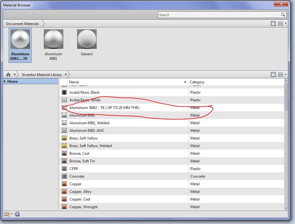

lkirit2000
Hi Roelof ,
Thanks for your prompt response.
I am not sure how to attach a material library, please see the attached image of inventor library . I have circled the newly created library.
Also attached materials library folder.
Rgds

Message 12 of 20
