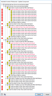

Just some more thoughts. Either of these may be related to the crash, but I am not sure if these are problems on my system, or if the crash may be related to modifications that need to be made to the assembly. (For example, I do not have Vault, so cannot "check out" the files).
  • When I open the assembly file, Inventor reports that updates need to be applied. But when I try to update the assembly, there are some errors. Are these "missing faces" also causing a problem with Nastran? (See the image below.)

Based on feedback from development, the problem is related to the unresolved or outdated components in the assembly. So perhaps another solution is to update the assembly.
