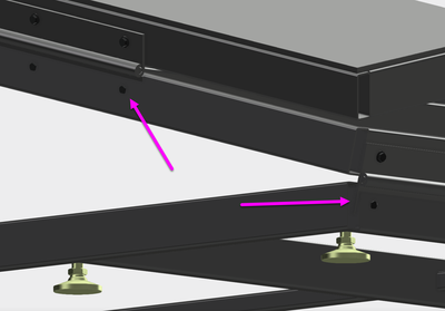

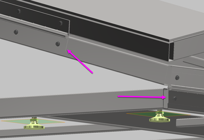

Per idea subject. Saving a model to the Autodesk Viewer that is in a positional representation - that also has sub-assemblies in positional references ends up the sub-assembly positions being ignored.
Correct in the assembly:
Not correct in the exported shared view (hinge leaves buried in the tubing):

@johnmondro4888, when using the simple dataset to try the workflow, it works fine. Please see the attached image. If possible, could you share the dataset with us for investigation? Thanks!Shared View.png
email: [email protected]
johnmondro4888
@Yijiang.Cai I sent the dataset to your email.
Yijiang.Cai
Status changed to: Accepted
Many thanks for posting the issue to us, and tracked as [INVGEN-60514].
