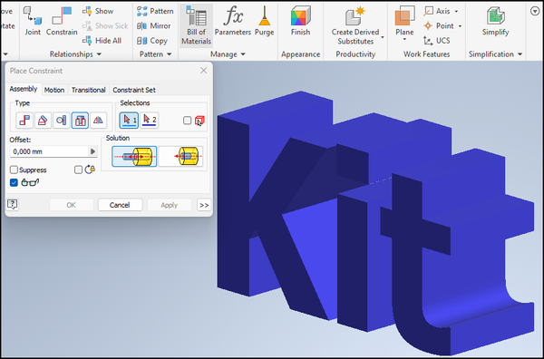

I would like to have the ability to apply or remove the rotational lock from an Insert Constraint by right clicking on the constraint.
This would be more efficient for the user not having to open the constraint dialogue click the box and exit the dialogue.

When you have forgotten to check the rotation lock for Assembly "Insert Constraints", within the Autodesk Inventor software, it is very time consuming to edit each Insert Constraint separately, in special when you have many of them!
With this add in you can lock them directly without the need editing them separately.
