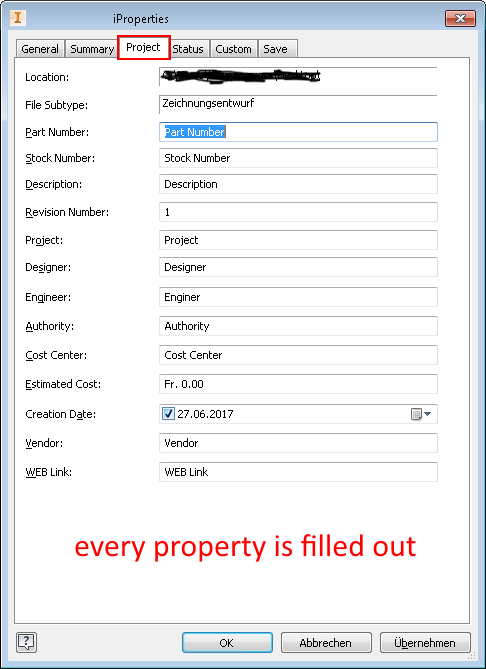

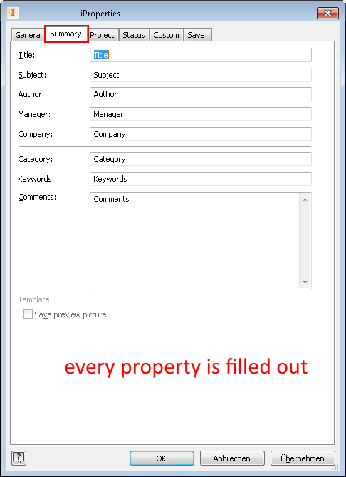

Example (Inventor 2017 and Adobe Reader DC)
How it is:
![01_Inventor_Summary.png 01_Inventor_Summary.png](https://forums.autodesk.com/t5/image/serverpage/image-id/371877i23AA6503F5DCD263/image-size/large?v=v2&px=999)
![02_Inventor_Project.png 02_Inventor_Project.png](https://forums.autodesk.com/t5/image/serverpage/image-id/371878iDDC70804DA45298B/image-size/large?v=v2&px=999)
![03_Inventor_Status.png 03_Inventor_Status.png](https://forums.autodesk.com/t5/image/serverpage/image-id/371879iB5D1C4446576AB7D/image-size/large?v=v2&px=999)
![04_Inventor_Custom.png 04_Inventor_Custom.png](https://forums.autodesk.com/t5/image/serverpage/image-id/371880i63D26259B1DE7B71/image-size/large?v=v2&px=999)
