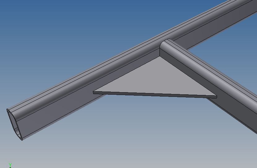

Have a quick and easy was to do gussets for frame generator
16 Comments
bverboort
Would result in a triangular plate based upon two or three faces/edges selected (or dimension or combination of both)
cadman777
We've been asking for this since 2002!
Just discovered the Frame Generator - very happy with it so far but the lack of a gusset design feature is a glaring gap in the program even to someone who's been using it less than 24 hours. Would have thought a gusset generator (could perhaps function similar to the Chamfer and Fillet features) would have been included a long time ago? Cheers.

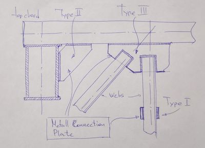

Frame Generator hasn`t instruments for metal connection plate. I would like introduce to you features for design connection plate, how it is work with design accelerator components.
 Type I - plate between 2 webs
0. Select start plane.
1. Select start face.
2. Select second face or create thickness.
3.  Placement start bottom face connection plate
4. Create height dimensions or stretch up plate.
 Type II - plate placement in a corner of metal frame, for example between webs and chord.
1. Select start plane
2. Create thickness plate or stretch thickness
3. Select 1 face
4. Select 2 face
5. Create dimension A or stretch face
6. Create dimension B or stretch face
7. Add edge 1 and move edge or create dimensions
8. Add edge 2 and move edge or create dimensions
9. Add edge 3 and move edge or create dimensions
10 Add edge 4 and move edge or create dimensions
 Type III - plate placement between webs or top chord.
2. Select start face
3. Create thickness plate or stretch thickness
4. Create dimension A or stretch face
5. Create dimension B or stretch face
6. Insert edges (4 edge).
7. Align or place perpendicular to the axis brace
iUser
They created Advance Steel for this, but would be great to see more features in frame generator. Or perhaps an add on of Advance Steel into Inventor (like a FEA addon).
didier.spinnewyn
It should be done only to put reinforcements in the frames as on the diagram type II.
For the other diagrams, it is indeed another software that is necessary.
Cordially.
