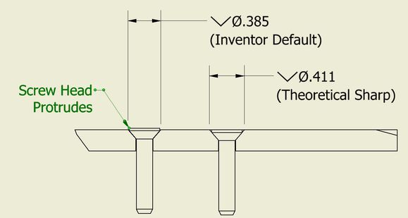

The countersink diameter created for flat head screw clearance holes using the Inventor Hole feature dialog is too small.  This causes the head of the screws to protrude above the surface of the part.  This is a problem.  The countersink diameter should be equal to or slightly larger than the "theoretical sharp" dimension to insure that the surface of the fastener is flush with or below the surface of the part.

Pretty much defeats the object of a countersink then...

Hi @Anonymous,
I can understand you what you mean, but in general you can edit the "Clearance.xls" located with the default installation of Inventor in the following path: C:\Users\Public\Documents\Autodesk\Inventor XXXX\Design Data\XLS\XXX2
Note:
  • XXXX = means the version of Inventor, for example 2020
  • XXXX2 = means the language pack you installed, (with languagepack) for example en-US, another is for example de-DE for the german localized installation of Inventor
I hope this help you, as Workaround at this time.

Cheers @mschindler-mum, a solution for now that if this picks up can be properly used.

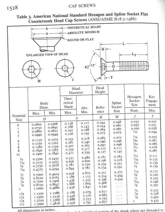

Does anyone know where the default Autodesk values actually come from?  Just wondering if the values are something Autodesk came up with, or if there's actually a standard out there somewhere that tells us to make these holes in a way that doesn't make a lot of sense dimensionally.
rhenstenburg
I use the values in Machinery's Handbook for "Hex and Spline Socket Flat Countersunk Head Cap Screws" (Table 6 under Cap and Set Screws in my version). Don't use the machine screw values.

My recollection is that the fasteners database was purchased.  So, where did the original company come up with their data (certainly does not match Machinery's Handbook values) and why wasn't the data vetted by Autodesk?
