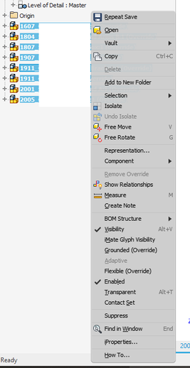

When upgrading from 2018 to 2021 all of my unconstrained positional views got completely wiped out as now the free floating objects are controlled though enabling position offset toggle. Why was this implemented? It has caused thousands of positional views to be broken and now I have to remake them all? Is there any way of setting this switch to default without a positional override?
Or can there be an easier way of toggling them on? Going 1 by 1 is very annoying.
Being able to select all of the components and hit one button. Maybe a quick access from the right click drop down.
Or possibly If anyone knows the function for this toggle I can build and Ilogic command where I select all of the components and then execute a script and it goes through and toggles that feature on for each component.

This is my current work-around with help from @Ralf_Krieg
Enable Position Offset of Selected Components
