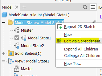

The current method is as follows:
  • Right click on the Model States folder node in the browser, and choose Edit via Spreadsheet
  • Type Appearance<style></style> into the cell at B1 (or just copy and paste it from here)
  • I'd just set them all to Default to start with, just because it's easy and avoids spelling errors and needing to know the exact names of all the colors
  • then close/save the spread sheet

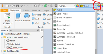

  • Now you can set each model state color/appearance as expected from the Appearance pull down menu.

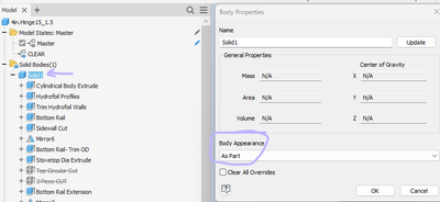

This did not work for me until I selected the Solid Body, right-clicked, Properties, set Body Appearance to "As Part"
