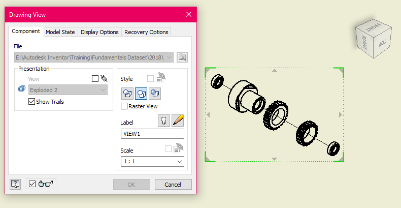

Currently in Inventor, when you place a view from a Presentation file, you get the option to select which Snapshot view you want to use:
However, once you have placed the view, if you want to change to a different Snapshot, the list is greyed out and it is not possible.
This would be a useful function and would maintain consistency across view generation, as you can change a normal assemblies View, Position and/or LOD after the view has generated.
