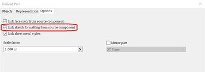

Message 8 of 8
emanuel.c
Just so nobody else has to knock their head on a wall... It wasn't working because I had "Link sketch formatting from source component" unselected in Derived Part -> Options.
So, the Dot vs Cross point that @johnsonshiue was mentioning wasn't carrying through, hence not working as you folks were showing.
