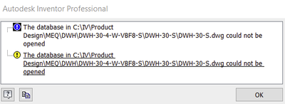

Greeted with this error several times over the last few days:
As some others have mentioned, the the "Beta: Use Windows Unicode-8 for worldwide language support" was already unchecked.
In this case I'm having repeated issues with the same file.  I've been forced to pull an old version from Vault to get it to open.  After editing, I save it & check it back into the Vault without issue.  When I go to open the dwg again (from Vault or from my local machine), I get the database error.  Obviously frustrating.

Interestingly, it appears that I was able fix my Inventor dwg by using AutoCAD.  Here are the steps I followed:
1 - Open AutoCAD.
2 - Select open & browse to the location of the Inventor dwg on local drive.  Open the file in AutoCAD.
3 - Error message displays.  Select "Recover."
4. Review recovery message .  Select "Close."
5. Save file & close AutoCAD.
6. Open Inventor dwg from local drive using Inventor.
7. Review error message & select "OK"
After following those steps the Inventor dwg appears to be functioning normally again.
