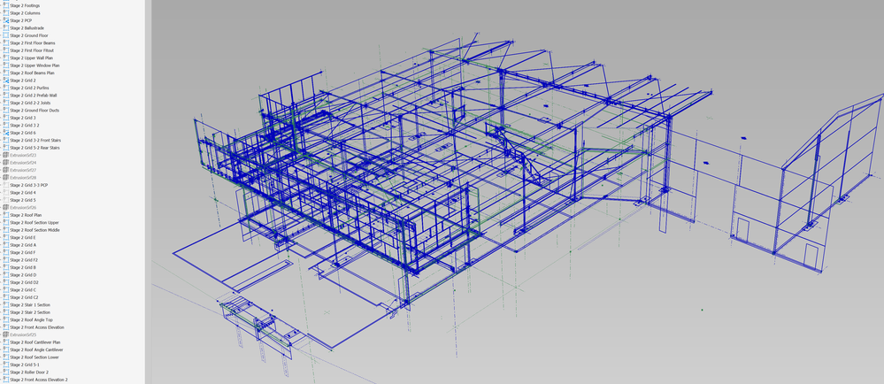

Desam
The only reason I would use the doubled step approach is to add further detail to existing sketches or add new sketches in the first derived skeletal level.  If the level of complexity in the skeleton sketches is really high then the skeletons themselves and the derived parts can be very slow to work on/update.   See below for an example that got out of hand and should have been split up more!
