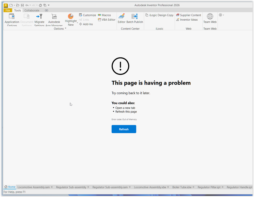

Got this rather unusual message come up on the Homepage of Inventor instead of the usual icons images of the files associated with the project

Hello.  Is there anything on your home page that is pointing to either a cloud site or a network location which could be offline at the time you see this?

I don't use The Cloud or any external storage, I don't like or trust them. When I closed it an tried again after post the problem all was OK. BUT I have notice and so have others that Inventor 2026 seems a bit buggy and temperamental compare to previous releases

Hi! I am not sure if the following article applies to you. But the error message seems to be the same as yours.
https://www.autodesk.com/support/technical/article/caas/sfdcarticles/sfdcarticles/Error-Code-Out-of-...
The article mentions it could be Chrome 32-bit related. The Chromium browser used by Homepage is 64-bit so I am a bit confused. Try a few things. Make sure all the critical Windows updates, the latest graphics driver, and all the critical PC vendor updates are installed. Use Windows Disk Cleanup to remove cached files.
How much system RAM and graphics RAM does your machine have?

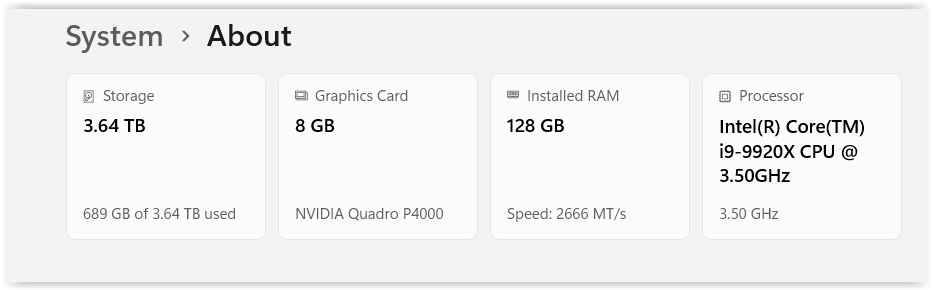

I've checked I am using the correct 64 bit Chrome browser
As for system RAM Thats 128GB
Graphics RAM on the Nvidia Quadro Pro is 8GB
As shown
