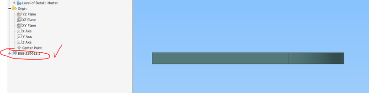

Greetings,
"Place and ground first component at origin" does not work properly when copying multiple parts from one assembly to another. If you copy only 1 element, it works ok and grounds it, but it does not work if you copy 2 or more at the same time.
We are using Inventor 2020.3.

I can reproduce what @ReneRepina is talking about.  If you select multiple components in an assembly and RMB copy or Crtl+C and then paste them into a new assembly nothing gets grounded.  If you use the place command and select multiple files it does ground the first component.  I'm using 2020.3

I believe what the originator was getting as is that the application option to automatically ground first component at origin does not work when copying and pasting multiple components.  It works fine if you only paste one component.

this is correct what @andrewiv said. It does not ground the first occurrence properly if you copy multiple occurrences from one assembly to a new one with Copy/Paste or CTRL + C/V.
