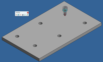

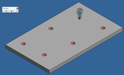

Previously (in both 2024 and 2025), when inserting a fastener from the Content Center, enabling Insert Multiple would automatically highlight all identical holes in red
This behaviour no longer occurs unless the Insert Multiple button is toggled off and then on again
As shown in this image, the button is active, yet only the initially selected hole is highlighted

Hi Matt, I just tried this in 2026.1 and it seemed to work ok.  EDIT - I got it to work once, but then on the next attempt (trying to record my screen) it did not work, and I had to toggle the Insert Multiple like you did.
Chris Benner
Roman_Vesely
Hi Matt,
 unfortunately it's a known issue tracked on our side as INVGEN-87324. We are working on fix.
