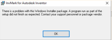

MarkusGreifeneder3360
Hi, I tried to install the latest Version.
With following result:
I tried to uninstall the "Edge WebView2-Runtime", but in Win10 it's not removable (greyed out), like mentioned in your youtube video.
Also tried a different pc with the same result....
Any idea what could help, to install this tool?
Message 171 of 180
ruben.vaneenoogheYGXKB
Hi Neil, first of all thank you for creating and maintaining this wonderful tool. We already used it in the past and were able to configure new pc's in a good and objective way.
We now tried to install the InvMark again on our current Windows 10 devices that run Inventor 2023, and just like #MarkusGreifeneder3360 we also get this error.
Would there already be a fix for this problem?
"There is a problem with this Windows Installer package. A program run as part of the setup did not finish as excepted. ... "
We don't get the error on Windows 11 devices. So for what we see for the moment, it seems to be a Windows 10 thing.
Kind regards, Ruben
Message 172 of 180
Hi, we also have no problems on win 11 machines. But on win 10.

da_matte
Hello, I wanted to use this to test our fleet of (admittedly aging) worksations, but the msi file refuses to install on most of them, stating the following:
"There is a problem with this Windows Installer Package. a program run as part of the setup did not finish as expected. Contact your support personnel or package vendor."
Given I'm the support personnel and am clueless, I'm posting here for any clues. yes it installed without issue on my windows 11 brand new PC. It will not install on the older workstations running windows 10.
Message 175 of 180
da_matte
Upon further inspection, it looks like many others are having the same issue. Forgive me for beating a dead horse, but if there's any tests I can do, please let me know.
Message 176 of 180
