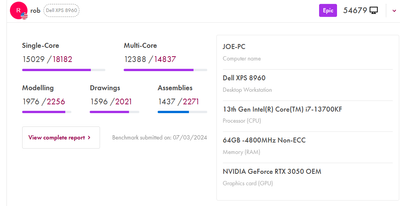

Logos_Atum
I´d partly blame the CPU´s single core performance. It surely is the last high end intel CPU that was a four core (in 2017), but it didn´t exactly age well. I´d also need more background on the dataset. Also, I agree, that the mem usage is something you can safely forget about in a pc sporting 24 GB of ram.
How many parts are we talking in this assembly?
EDIT:
listed below is just the difference in Single Core Cinebench R15 tasks. And as not everything is about rendering, the difference is much bigger in any regard and all over the board. I gathered this from Igor´s Lab.
You can also compare INVMARK results for your CPU with a recent system.
That´s the closest I found, the slightly faster K version of your CPU.
And that´s the first place
Even if the GPU in the first up and runner is overkill, setups with a 3050 only score a little less.
