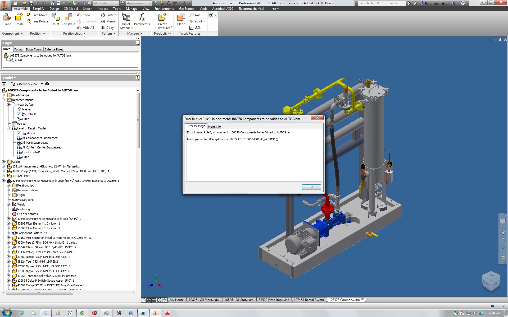

Can anyone run this code? Do you get an error? If an error occurs, how is said error corrected?

yes
Message 4 of 13
and

Threw up errors again. Here is a screen shot of that information.
Message 10 of 13
MechMachineMan
I have a really good idea what's wrong. But I'm going to let you figure it out.
Look at your error windows and read.
One of the lines sticks out as familiar - "get.BomStructure"
This tells us it's either that function or something invoked by/related to that function.
Run a basic name check of the occurrences and let me know how that goes.
Let me know if you see anything weird.

it did partially work & I think I noticed it wanted the part to be checked out by the user running the code.
Message 12 of 13
This is all greek to me. I have no idea where to start. However, when I tried the rule on a single subassembly with just parts, it worked well. SO maybe the problem is the subassemblies within an assembly?
Message 13 of 13
I noticed I had less problem when I had everything checked out. Other than that. I have no idea. I'm such a novice with code that I don't know where to start to look.
