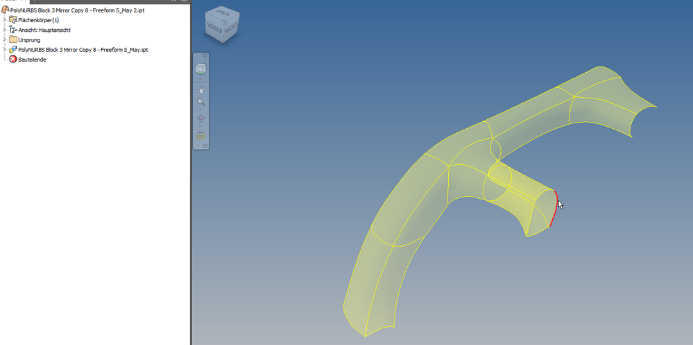

S_May
@ZEBAS70,
make small steps as in the pattern..
2018-06-05 11_18_13-Autodesk Inventor Professional 2019.png2018-06-05 11_34_07-Autodesk Inventor Professional 2019 - [PolyNURBS Block 3 Mirror Copy 8 - Freefor.png2018-06-05 11_34_32-Autodesk Inventor Professional 2019 - [PolyNURBS Block 3 Mirror Copy 8 - Freefor.png
ZEBAS70
Hi S_May thanks for your reply....yes I've tried working out small parts of the model Smiley LOL ..... I think that could be an option.... but I'm going to do some FEA after that so I don't know if the small parts will really be joint together...actually there are some sections where this error message show up !!! Thanks anywaySmall Steps in Thicken.PNG
