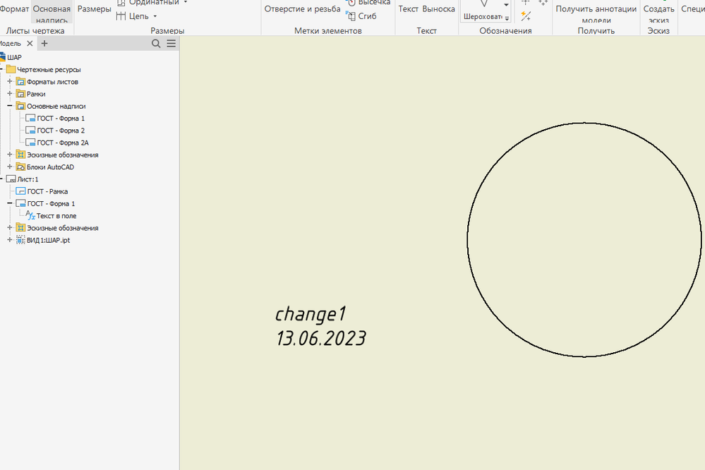

89198826955
1. right click "properties"
2. tab "other"
3. add a custom parameter "modified date"
4. on the drawing "text"
5 "custom properties"
6.ok
