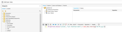

The iProperties (in your screenshot) are set manually, so unfortunately, you won't see them change when saving.
There is a "Last modified" property on the drawing file which records the last time you saved it (see the "General" tab of iProperties).  To access it though, you'll need a line of iLogic to push the date into either a custom iProp, or a standard iProp - whichever is your preference.
I use a slightly simpler approach and grab the 'now' variable, capturing only the date (and you can mess with the formatting of the date easily by swapping the text around):
iProperties.Value("Custom", "Last Modified Date") = Date.Now.ToString("dd-MM-yyyy")
Set a trigger to run the rule "Before Save", and then save it into your drawing template.

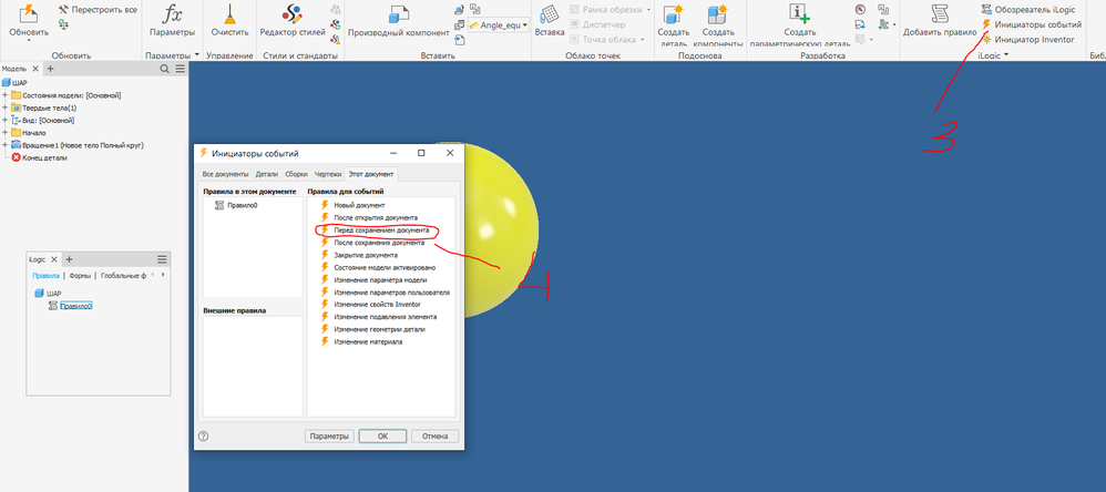

I selected before save document but it seems to give no confirmation on it being active/saved or added as a rule.

89198826955
my opinion:
it is better to mark the change manually
this will prevent accidental saving
see topic"How to insert the PART Modification Date into the drawing"

It looks like you have both options now - automatic and manual.
Nice explanation for creating the rule @89198826955 - thank you for filling in all the bits I missed!
I followed your link: Solved: How to insert the PART Modification Date into the drawing - Autodesk Community - Inventor - However, reading the replies, it looks as though the other contributors would prefer an automatic option, so I'll post a link back here to this thread.
@MatsNorway1 - In your last screenshot, you don't appear to have added the rule under "Before Save Document". (Drag and drop the rule.)
After you save your document, check the Custom iProperties.  You should find the new custom iProperty.
