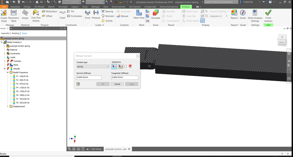

I am doing an fea analysis in Autodesk Inventor.
And I want to give a spring in my design a torsional stiffness of 750 Nm/rad, how can I do that?

So, between the hinges there must be a spring with a torsional stiffness of 750 Nm/rad

I want to determine the natural frequency of the beam.
There is a torsion spring between the hinge leafe and beam.
I want to give the spring a torsional stiffness of 750 Nm/rad, but in Inventor I only can give the spring a normal or tangential stiffness

Hi! I don't believe you can assign torsion stiffness or torsion constant in FEA. It is because the property depends on shape. It is a calculated property, not an assigned property like Young's modulus or density.
